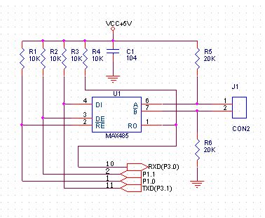

为什么上位机和下位机的小灯都没有亮?
上位机程序:
[code]
#include <reg52.h>
#include <string.h>
#define uchar unsigned char
#define _RDY_    0x06
#define _OK_    0x00
uchar tmp;
sbit M_DE = P1^0;
sbit M_RE = P1^1;
void initSerial()
   TMOD = 0x20;
   TH1 = 250;
   TL1 = 250;
   TR1 = 1;
   PCON = 0x80;
   SCON = 0x50;
void main (void)
   uchar LED;
   initSerial();
   EA = 0;
   M_DE = 1;        //置发送允许,接收禁止
   M_RE = 1;
   TI = 0;
   SBUF = _RDY_;
   while(!TI)
   TI = 0;
   while(tmp != _OK_)
       RI = 0;
       while(!RI);
       tmp = SBUF;
       RI = 0;
   while(1)
       LED = 0xfe;
       P0 = LED;
[/code]
下位机程序:
[code]
#include <reg52.h>
#include <string.h>
#define _RDY_    0x06
#define _OK_    0x00
uchar tmp;
sbit M_DE = P1^0;
sbit M_RE = P1^1;
void initSerial()
   TMOD = 0x20;
   TH1 = 250;
   TL1 = 250;
   TR1 = 1;
   PCON = 0x80;
   SCON = 0x50;
void main (void)
   uchar LED;
   initSerial();
   EA = 0;
   M_DE = 0;        //置接收允许,发送禁止
   M_RE = 0;
   while(1)
       while(tmp != _RDY_)
           RI = 0;
           while(!RI);
           tmp = SBUF;
           RI = 0;
       TI = 0;
       SBUF = _OK_;
       while(!TI);
       TI = 0;
       while(1)
           LED = 0xfe;
           P0 = LED;
[/code]
