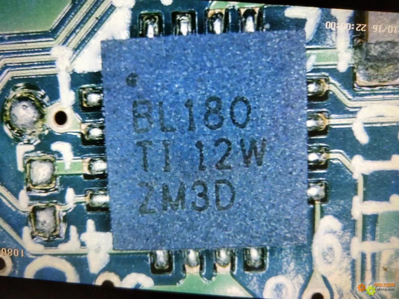

请问芯片功能??????????

485芯片SN65LBC180RSA
