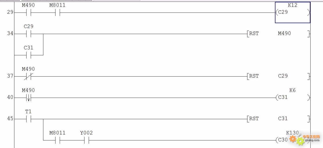

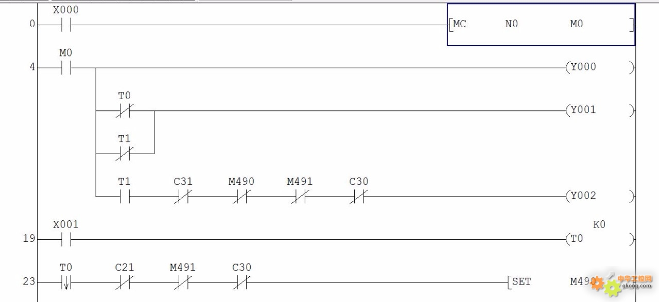

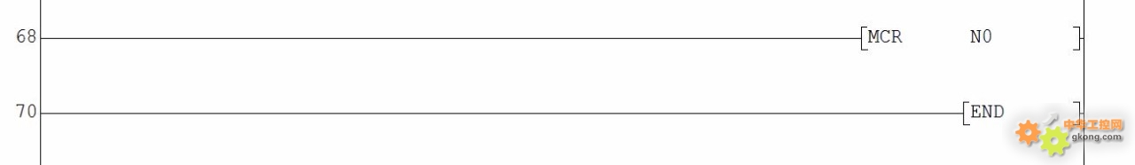

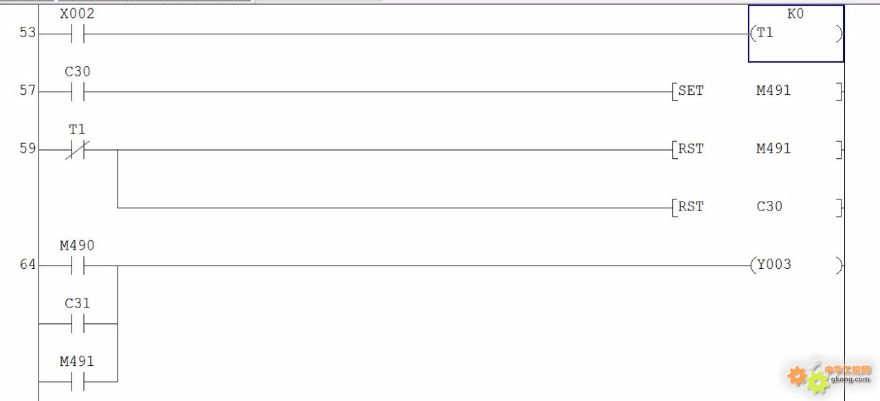

哪位大神能帮我把这个指令表转化为梯形图

以下是引用小渔儿在2018/1/9 1:55:08的发言:
哪位大神能帮我把这个指令表转化为梯形图
0   LD      X000
1   MC     N0
              M0
4   LD      M0
5   OUT   Y000
6   MPS
7   LDI     T0
8   ORI    T1
9   ANB
10   OUT    YOO1
11    MPP
12    AND    T1
13    ANI     C31
14    ANI     M490
15    ANI     M491
16    ANI     C30
17    OUT    Y002
18    NOP
19    LD      X001
20    OUT   T0
                 K0
23    LDF    T0
25    ANI     C31
26    ANI     M491
27    ANI     C30
28    SET    M490
29    LD      M490
30    AND   M8011
31    OUT    C29
                 K12
34    LD      C29
35    OR     C31
36    RST    M490
37    LDI     M490
38    RST    C29
40    LDF    M490
42    OUT   C31
                 K6
45    LD      T1
46    RST    C31
48    AND   M8011
49    AND   Y002
50    OUT   C30
                 K130
53    LD      X002
54    OUT    T1
                 K0
57    LD      C30
58    SET    M491
59    LDI     T1
60    RST    M491
61    RST    C30
63    NOP
64    LD      M490
65    OR     C31
66    OR     M491
67    OUT   Y003
68    MCR   N0
三菱FX系列。
Sir:
Good Luck~
