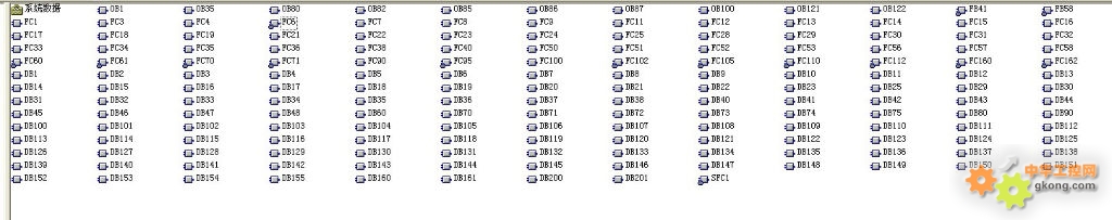

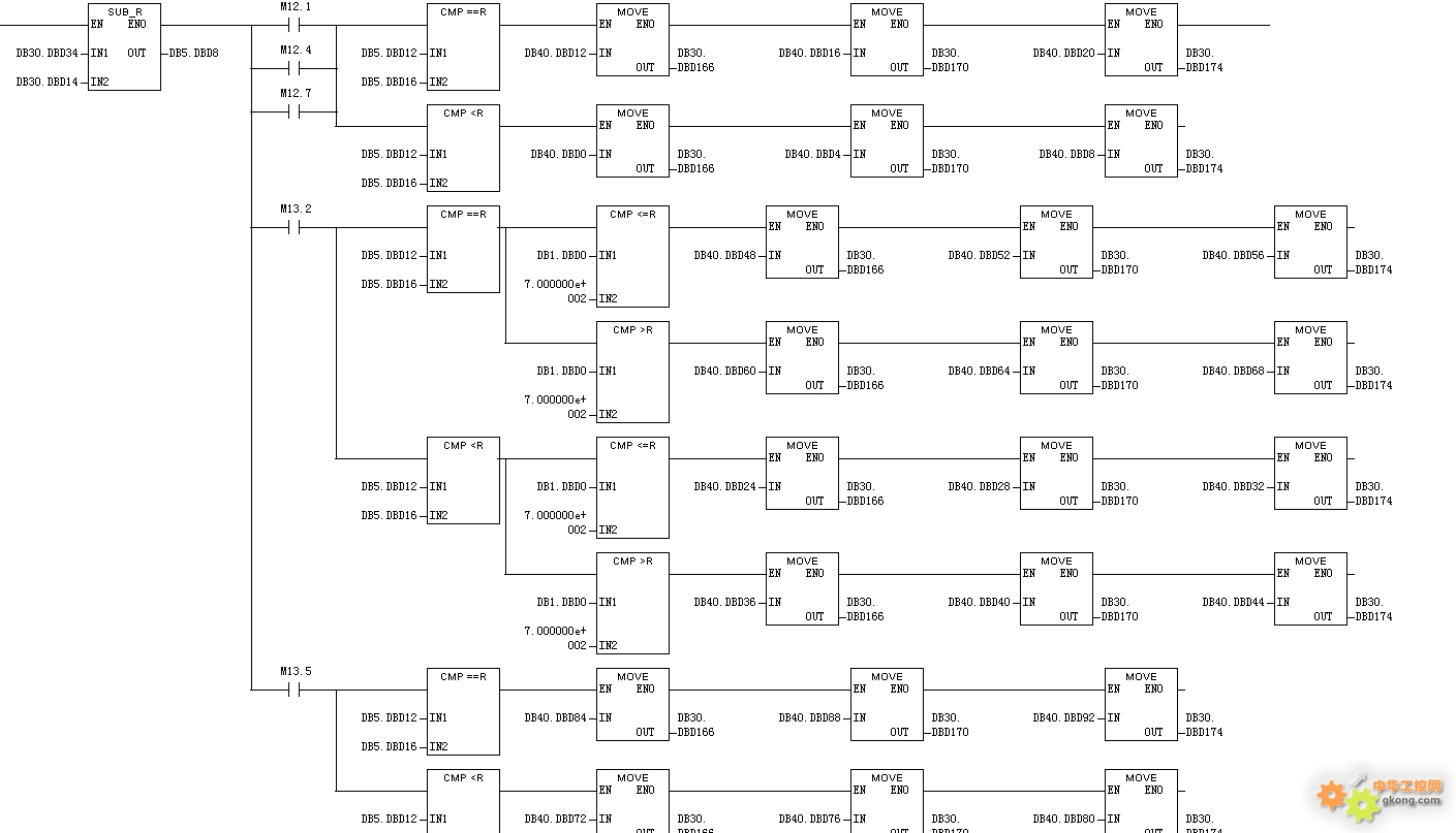

     SET
     SAVE
     =     L      0.1
     L     #IN0
     L     1.000000e+001
     ==R
     JCN   M001
     L     1.000000e+002
     T     #RET_VAL
     L     1.000000e+005
     T     #OUT1
     JU    M002
M001: L     #IN0
     L     7.429000e+000
     -R
     L     1.790502e+000
     *R
     EXP
     T     #RET_VAL
     L     #RET_VAL
     L     1.000000e+003
     *R
     T     #OUT1
M002: CLR
     A     L      0.1
     SAVE
     BE
