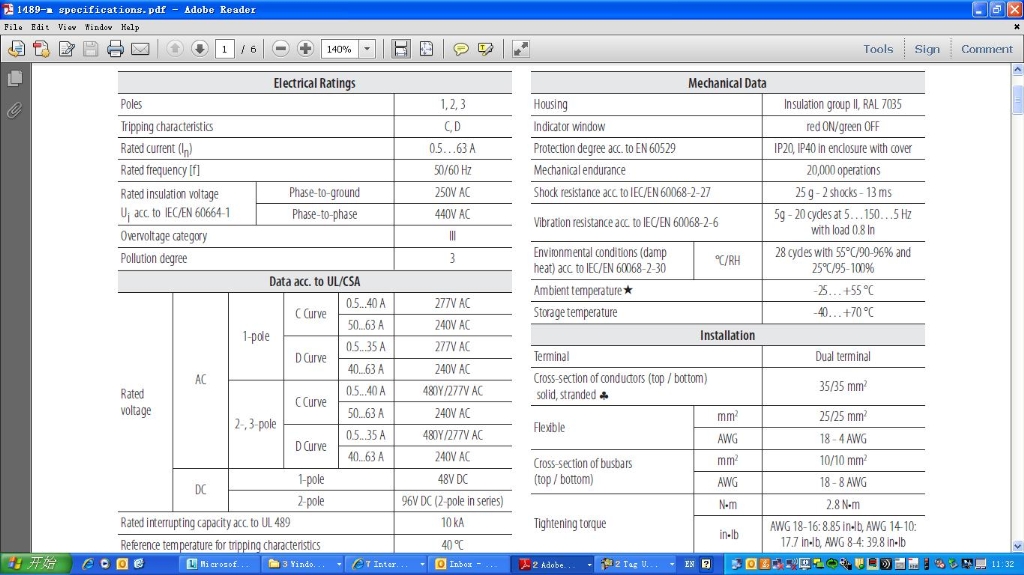

大家帮忙看看AB的断路器用西门子或者施耐德如何替代?
1. 1489-M2D150      Bulletin 1489 Miniature Circuit Breaker, Standard configuration, AC, 2 Pole Configuration, Trip Curve D, 15 A
http://raise.rockwellautomation.com/RAConfig/resultsComponents.asp?CID=B008ECC4032B41438EDBDF57F0D4436C;

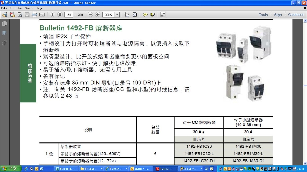

2. 492-FB2C30-L   带熔断指示灯的熔断器装置FUSE HOLDER, 600 V, 30 A    2 POLE, FUSE CLASS CC
