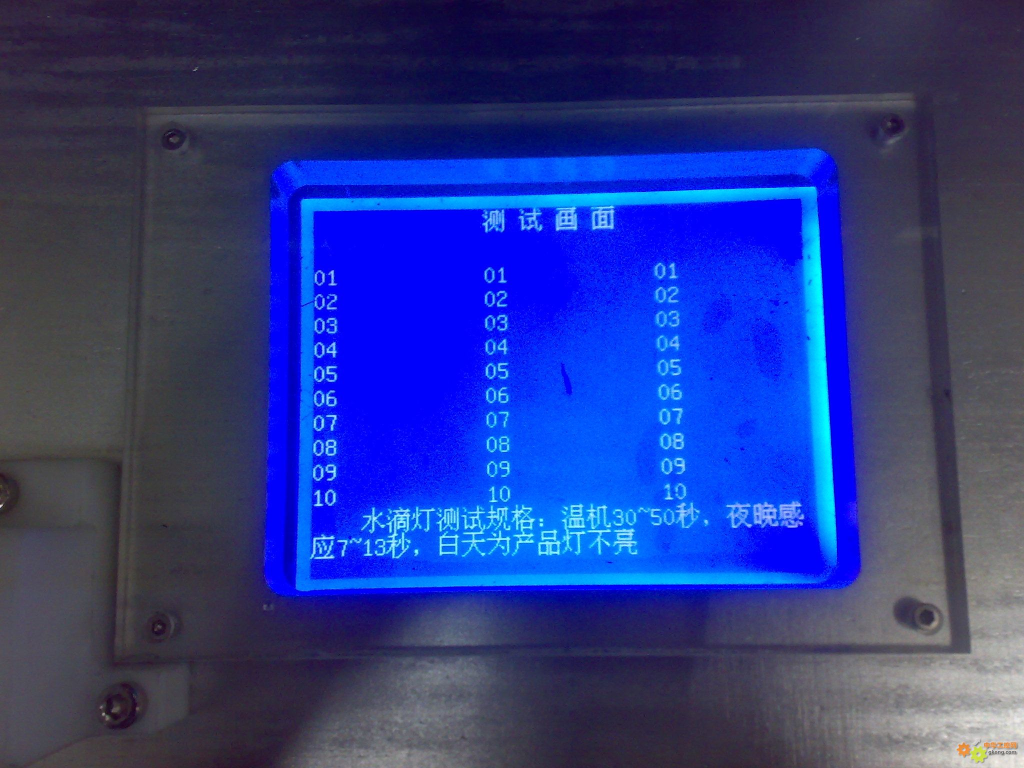

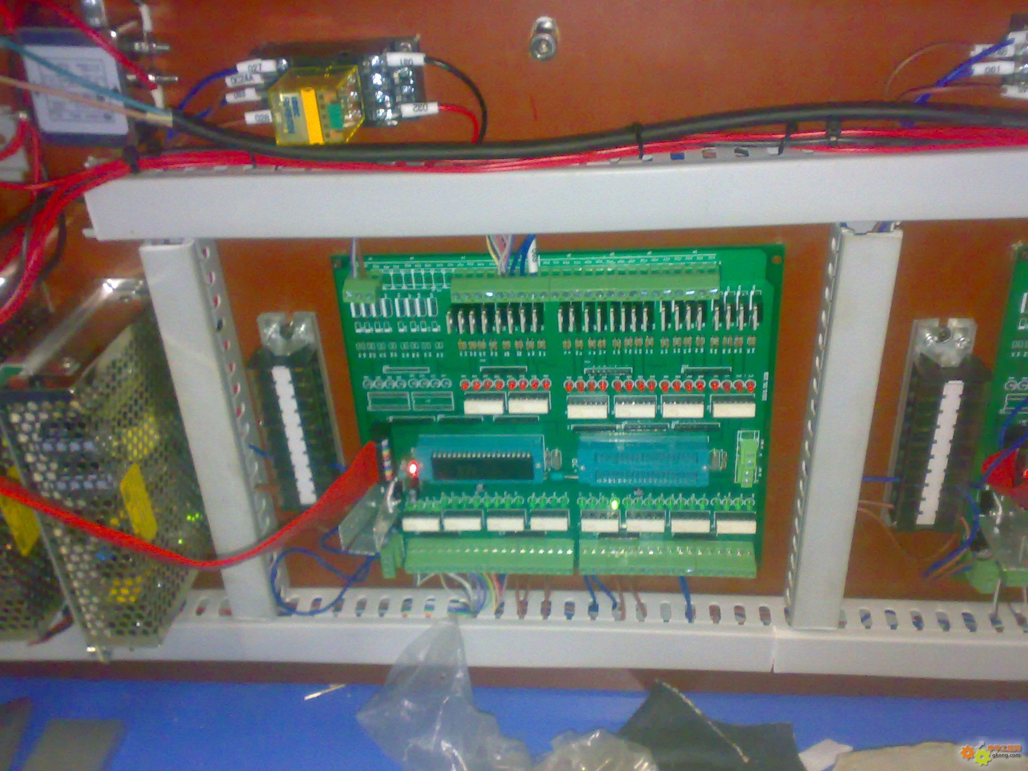

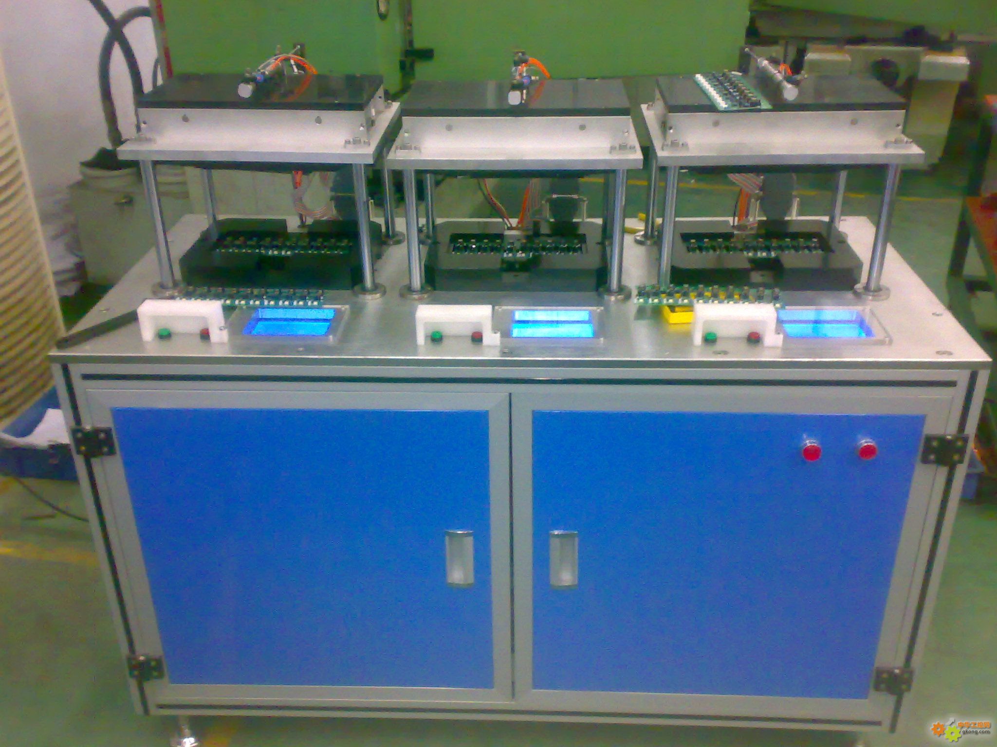

//****     多功能PCB板测试机         ********
//****2010.6.19    STC90C58RD     12MHZ******
//P0 P4口做LCD显示HS320240

#define DATA_BUS P0
unsigned char code str00[]="多 功 能 测 试 机";
unsigned char code str01[]="Version 1.00";
unsigned char code str02[]="温机NG, s";
unsigned char code str22[]="          ";
unsigned char code str03[]="感应NG, s";
unsigned char code str23[]="          ";
unsigned char code str04[]="LUX NG";
unsigned char code str24[]="      ";
unsigned char code str05[]="温机OK, s";
unsigned char code str06[]="感应OK, s";
unsigned char code str07[]="LUX OK";
unsigned char code str08[]="测 试 画 面";
unsigned char code str11[]="01";
unsigned char code str12[]="02";
unsigned char code str13[]="03";
unsigned char code str14[]="04";
unsigned char code str15[]="05";
unsigned char code str16[]="06";
unsigned char code str17[]="07";
unsigned char code str18[]="08";
unsigned char code str19[]="09";
unsigned char code str20[]="10";
unsigned char code str21[]="水滴灯测试规格:温机30~50秒,夜晚感应7~13秒,LUX为产品灯不亮";

void zhuye()//显示器主页
   delay(100);
WDT_CONTR=0X34;
LcdInit();  //初始化
LcdClear(0); //清屏
delay(5);
DisplaySW(1); //开显示
delay(5);
PutStr(12,0x60,str00);
   PutStr(20,0xc0,str01);
   delay(500);
   delay(300);
   WDT_CONTR=0X34;
   delay(500);
   WDT_CONTR=0X34;
   LcdClear(0);
   delay(3);
   DisplaySW(1);
void chizhuye()//次主页
{   bit xunhuan00=0;
   unsigned int xunhuan01=0;
PutStr(14,0x00,str08);//显示测试页面
while(0==xunhuan00)
PutStr(xunhuan01,0x24,str11);//01
PutStr(xunhuan01,0x34,str12);//02
PutStr(xunhuan01,0x44,str13);//03
PutStr(xunhuan01,0x54,str14);//04
PutStr(xunhuan01,0x64,str15);//05
PutStr(xunhuan01,0x74,str16);//06
PutStr(xunhuan01,0x84,str17);//07
PutStr(xunhuan01,0x94,str18);//08
PutStr(xunhuan01,0xa4,str19);//09
PutStr(xunhuan01,0xb4,str20);//10
if(28==xunhuan01)
    xunhuan00=1;
if(14==xunhuan01)
   xunhuan01=28;
if(0==xunhuan01)
   xunhuan01=14;
WDT_CONTR=0X34;
PutStr(4,0xc4,str21);//产品规格
   delay(200);
WDT_CONTR=0X34;

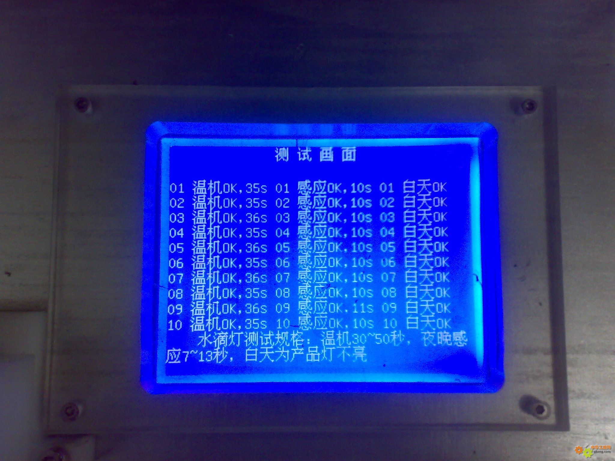

void wenjijieguoxianshi()
  WDT_CONTR=0X34;
////////////温机结果01
   if((wenjinchuansong01>=30)&(wenjinchuansong01<=50))
    PutStr(3,0x24,str05);//显示温机OK,温机  s
else
 if(xianshizhuanhuan)
   PutStr(3,0x24,str22);//空白               //
 else
      PutStr(3,0x24,str02);//显示温机NG,温机  s
zuanhuan(10,0X24,wenjinchuansong01);//实际秒数

发表于:2010/6/23 21:47:18
还以为没人看,程序本来不是太长,只是行间距太大,呵呵,改天传上流程图和一些显示图片吧!
4144
sankyo_feng
文章数:732
年度积分:55
历史总积分:4144
注册时间:2006/11/8
发表于:2010/7/7 19:24:44
不好意思,这几天有点忙,一直没有将图传上来。
4144
sankyo_feng
文章数:732
年度积分:55
历史总积分:4144
注册时间:2006/11/8
发表于:2010/7/7 19:29:17
有图有真相,呵呵
