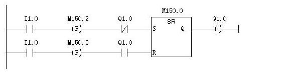

也给大家一个
LD 0000
OR 1000
AND NOT CNT000
OUT 1000
LD 0000
CNT 000
#02
END
