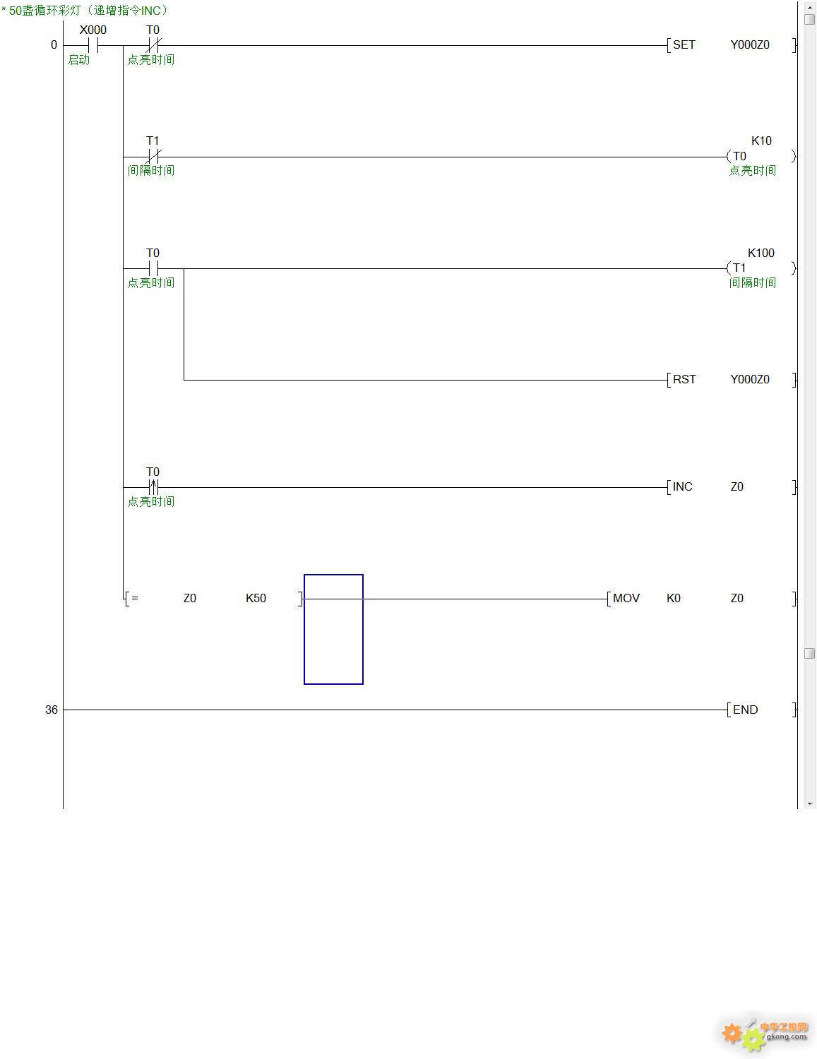

8彩灯循环闪烁程序_FX3U
附件:
[本地下载]
5466

50盏循环彩灯(用递增指令INC)
0 LD X000
1 MPS
2 ANI T0
3 SET Y000Z0
6 MRD
7 ANI T1
8 OUT T0 K10
11 MRD
12 AND T0
13 OUT T1 K100
16 RST Y000Z0
19 MRD
20 ANDP T0
22 INC Z0
25 MPP
26 AND= Z0 K50
31 MOV K0 Z0
36 END
