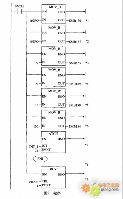

发表于:2015/3/7 19:46:43
LD     SM0.1
MOVB   16#09, SMB30
MOVB   16#B0, SMB87
MOVB   16#0A, SMB89
MOVW   +5, SMW90
MOVB   15, SMB94
ATCH   INT_0:INT0, 23
ENI
RCV    VB200, 0

回复 #3楼 wushulin
PLC接收是没问题的,能接收电脑串口的数据
