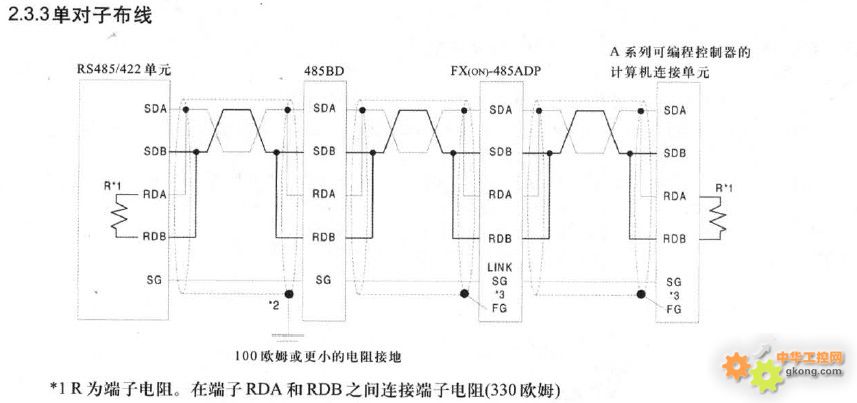

FX2N485BD要求有一个终端电阻(485-1只,422—2只),请问,只有一台PLC、一台PC机,这个终端电阻要否?谢谢

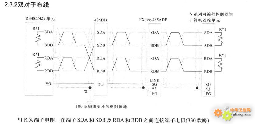

发表于:2014/1/22 14:16:35

发表于:2014/1/22 14:23:18
2.3.2 Two-pair Wiring
*1 R is the terminating resistance. Connect the terminating resistance (330W) between terminals SDA
and SDB, and terminals RDA and RDB.
2.3.3 One-pair Wiring
*1 R is the terminating resistance. Connect the terminating resistance (110W) between terminals RDA
and RDB.
我看了看手册
中文版的手册错了,楼主还是加个电阻吧
