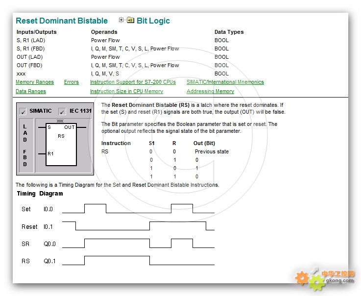

梯形图中怎么画PEEP指令?谢谢!

Good Luck~
