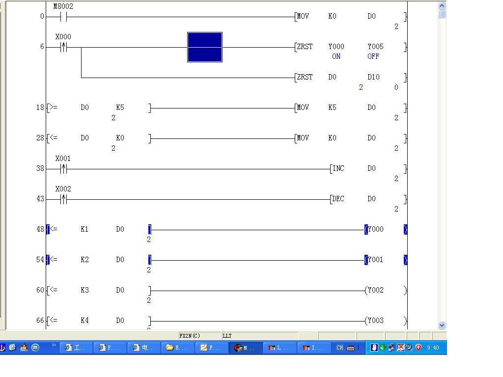

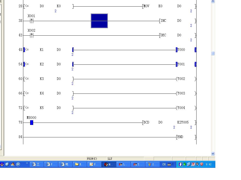

初学者三菱的
LD       X001
SFTLP  X001  Y001  K5  K1
LD       X002
SFTRP  X000  Y001  K5  K1
LD       X000
OR       M8002
ZRST   Y001  Y005
LDI      Y001
MOV    K63    K2Y010
LD       Y001
MOV    K6      K2Y010
LD       Y002
MOV    K91    K2Y010
LD       Y003
MOV    K79    K2Y010
LD       Y004
MOV    K102  K2Y010
LD       Y005
MOV    K109  K2Y010
END
