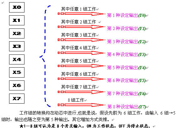

///////用Pro-face的人機可寫成這樣///////////
if ([b:X0000]==1)
[w:D0000]=1
else
[w:D0000]=0
endif
if ([b:X0001]==1)
[w:D0001]=1
else
[w:D0001]=0
endif
if ([b:X0002]==1)
[w:D0002]=1
else
[w:D0002]=0
endif
if ([b:X0003]==1)
[w:D0003]=1
else
[w:D0003]=0
endif
if ([b:X0004]==1)
[w:D0004]=1
else
[w:D0004]=0
endif
if ([b:X0005]==1)
[w:D0005]=1
else
[w:D0005]=0
endif
if ([b:X0006]==1)
[w:D0006]=1
else
[w:D0006]=0
endif
if ([b:X0007]==1)
[w:D0007]=1
else
[w:D0007]=0
endif
[w:D0008]=[w:D0000]+[w:D0001]+[w:D0002]+[w:D0003]+[w:D0004]+[w:D0005]+[w:D0006]+[w:D0007]
if ([w:D0008]==0)
clear([b:Y0000])
clear([b:Y0001])
clear([b:Y0002])
clear([b:Y0003])
clear([b:Y0004])
clear([b:Y0005])
clear([b:Y0006])
clear([b:Y0007])
endif
if ([w:D0008]==1)
set([b:Y0000])
clear([b:Y0001])
clear([b:Y0002])
clear([b:Y0003])
clear([b:Y0004])
clear([b:Y0005])
clear([b:Y0006])
clear([b:Y0007])
endif
if ([w:D0008]==2)
set([b:Y0001])
clear([b:Y0000])
clear([b:Y0002])
clear([b:Y0003])
clear([b:Y0004])
clear([b:Y0005])
clear([b:Y0006])
clear([b:Y0007])
endif
if ([w:D0008]==3)
set([b:Y0002])
clear([b:Y0001])
clear([b:Y0000])
clear([b:Y0003])
clear([b:Y0004])
clear([b:Y0005])
clear([b:Y0006])
clear([b:Y0007])
endif
if ([w:D0008]==4)
set([b:Y0003])
clear([b:Y0001])
clear([b:Y0002])
clear([b:Y0000])
clear([b:Y0004])
clear([b:Y0005])
clear([b:Y0006])
clear([b:Y0007])
endif
if ([w:D0008]==5)
set([b:Y0004])
clear([b:Y0001])
clear([b:Y0002])
clear([b:Y0003])
clear([b:Y0000])
clear([b:Y0005])
clear([b:Y0006])
clear([b:Y0007])
endif
if ([w:D0008]==6)
set([b:Y0005])
clear([b:Y0001])
clear([b:Y0002])
clear([b:Y0003])
clear([b:Y0004])
clear([b:Y0000])
clear([b:Y0006])
clear([b:Y0007])
endif
if ([w:D0008]==7)
set([b:Y0006])
clear([b:Y0001])
clear([b:Y0002])
clear([b:Y0003])
clear([b:Y0004])
clear([b:Y0005])
clear([b:Y0000])
clear([b:Y0007])
endif
if ([w:D0008]==8)
set([b:Y0007])
clear([b:Y0001])
clear([b:Y0002])
clear([b:Y0003])
clear([b:Y0004])
clear([b:Y0005])
clear([b:Y0006])
clear([b:Y0000])
endif

8楼的兄弟,你的程序我用S7-200仿真软件运行不了呀?
请指教。
始终如一
3320
litianxi
文章数:942
历史总积分:3320
注册时间:2001/4/10
发表于:2004/10/27 21:54:00
#18楼
以下是引用lyping在2004-10-27 16:20:00的发言:
请指教。
我从来就没用成功过仿真软件.
不过该程序我在PLC上调试通过,应该是比较简洁的解决方法.
